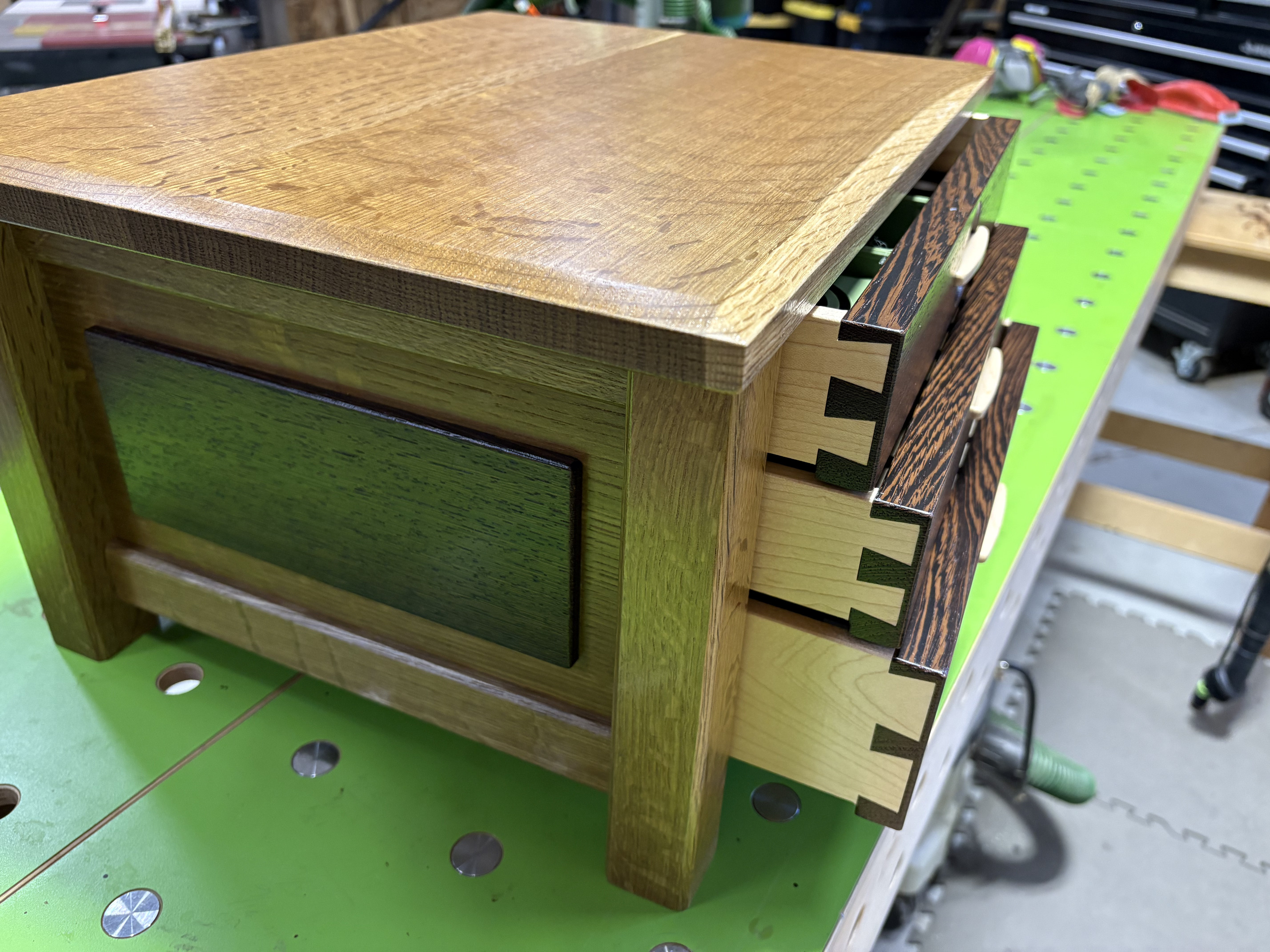

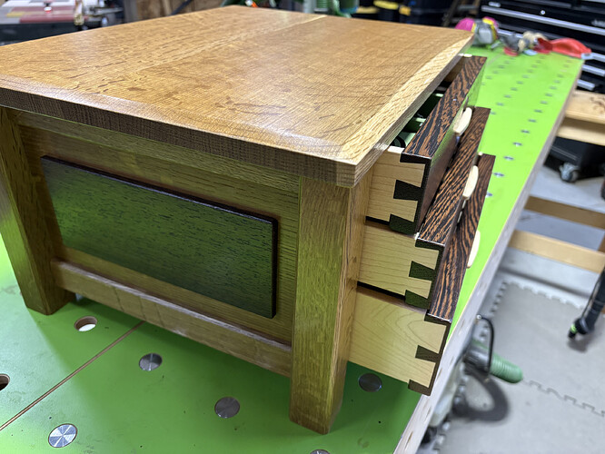

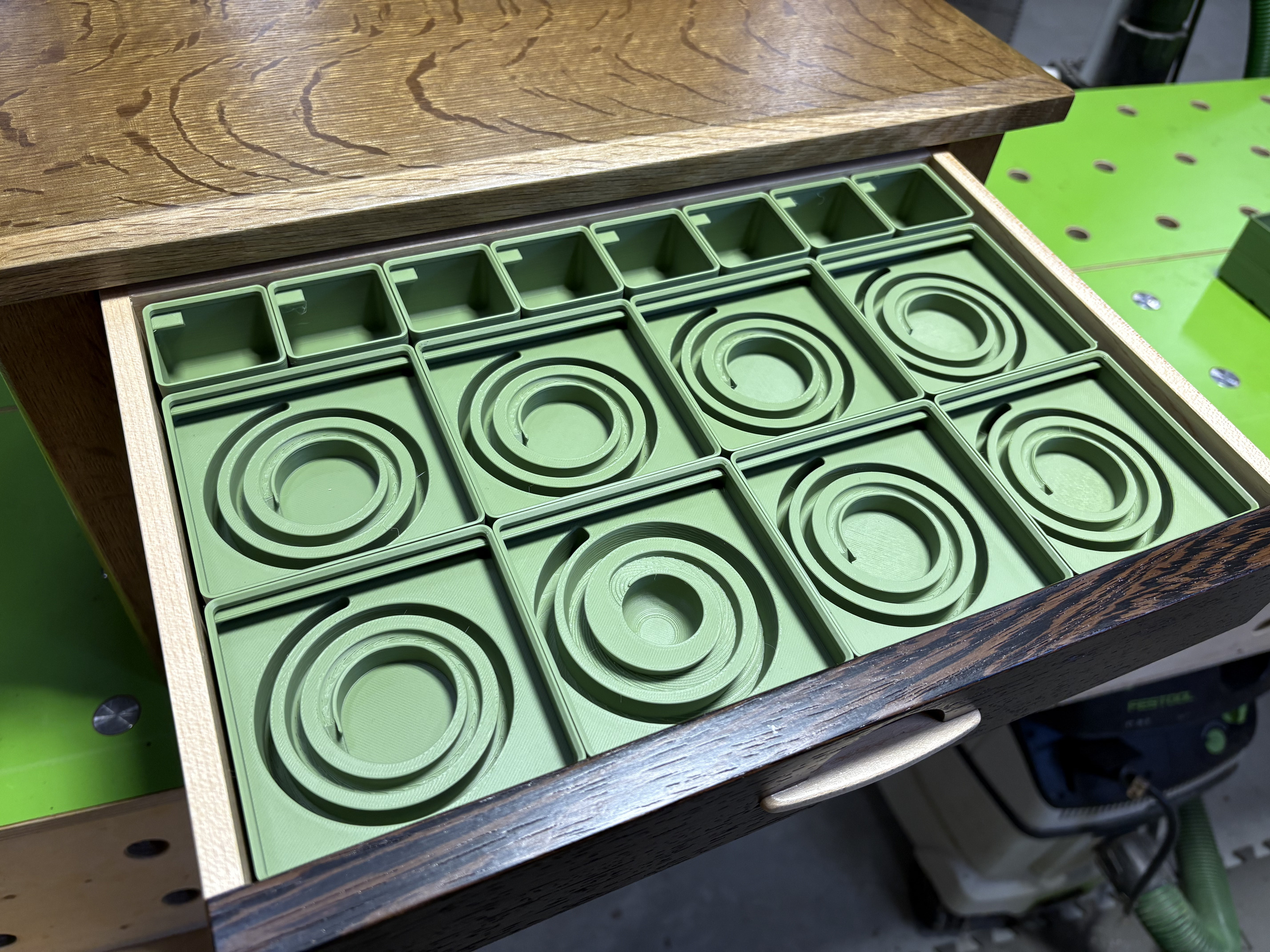

Update with pictures of the (MOSTLY) finished box. Need to fume the oak part of color, then spray poly on everything. Still printing all the gridfinity components for organizing the jewelry.

somehow I screwed up and the drawers ended up just a tad too narrow for the 42mm x 8 (despite planning for 2mm extra), but then I realized the gridfinity macro in F360 allows you to customize the “standard”. So I switched them all to 41.5….. WINNING!
Updating with final finished pictures. Box delivered, wedding went perfect, new bride loves it!
36 hours fuming with 29% ammonia, then satin polyurethane top coat.
That looks awesome what were your wood choices
Quartersawn White Oak (leftovers from another project),
Hard Maple,
Wenge.
