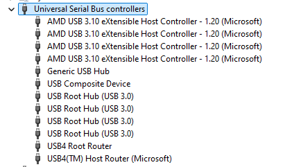

Went into device manager and saw that the usb controllers were set to be allowed to turn off. No idea which of the massive list of controllers is the right one/why there are so many duplicates but I went through and unchecked that box on all of them. I have not been able to get the lag to reoccur after jogging around for a few minutes here!
The tech bulletin that gets pulled up after running the PC tuner mentions to do this for the Ethernet adapter but not the USB adapter. Promising fix!
You can look at the list, then unplug the RF module for the pendant and that device should dissapear. Plug it back in and find the re-appeared device edit the driver parameters.
Was trying that but nothing was changing… so I just did them all.

It looks like the WMPG-6 is a WixHC unit that shows up as a generic HID-compliant vendor-defined device in Windows (under Human Interface Devices in Device Manager, device ID should be VID_10CE&PID_EB91). On my machine, the option to allow the computer to turn off the device to save power is greyed out, but it may be worth it to make sure it’s not selected (or is greyed out) on your device. You can set it be greyed out (i.e. unselectable) yourself by doing something like: Disable "Allow this computer to turn off this device to save power" for I2C HID device solely - Microsoft Q&A
On my pc, it seems to be named “USB input device.” It was already set to not be powered off.
I did notice that it randomly dropped out and back into device manager without me touching anything while looking at this.
