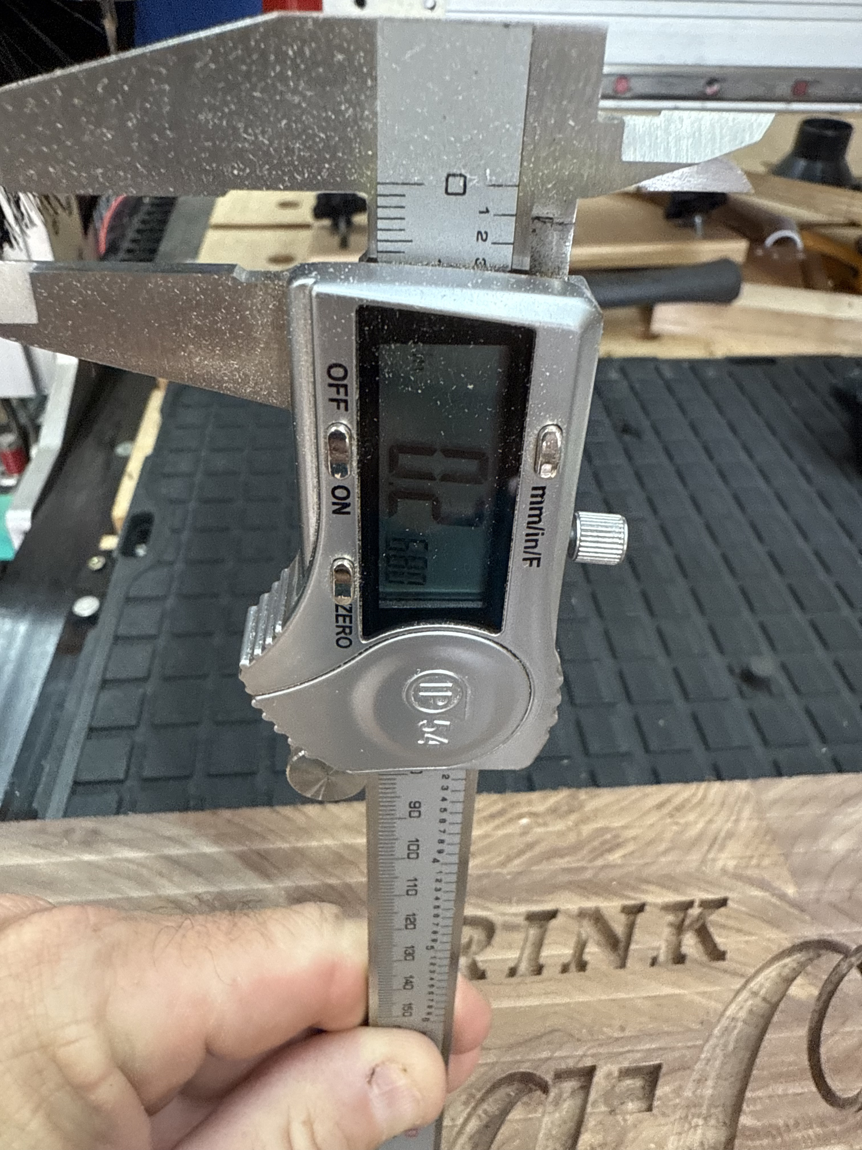

I have run several tests to no avail trying to see why my called for depth is not what is carved. This is new for me on the EX controller. When I used mach this was not an issue. I am trying to run a depth of .25 and I am continually .02 deeper than it needs to be. In most cases this is not an issue but when I do inlays I need precision. I have zeroed using my touch plate and checked the top of the material with my bit and I am with .004 using a feeler guage. When I check the pocket its too deep.

I have done multiple tests before today using the airweights and other methods. I have screwed and nailed things down and still get the same problem. I find it very odd that it is always around .02 off. To me if it was workholding where something was popping up, it would vary in spots
Is it only when you are cutting, or even when you just do a jog? Like if you put a dial indicator on and just jog up/down, does it move the programmed amount (like if you just type something in the MDI window)?
The problem is when I cut. The DRO reads the right depth but its not cutting to what it says. I have tried multiple calipers to see if that was the issue and they all read the same. I am stumped

I’m checking everything. Using flat material and even checking tram. Only thing I see if that my title front to back is off by .04 but not sure that would have an effect on depth. I ran 1/4 hole and I got the proper depth once and then the next hole wasn’t. It’s just very odd that it’s off the same amount.
