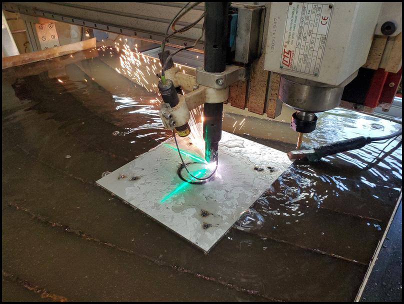

Next up it was over to the AVIDcnc with some 1/4in stainless steel plate to make the “handle” portion.
In a complete display of USER ERROR, I ran this cut a bit tooo slow and in thicker stainless, the THC on the plasma cutter is quite unforgiving. The machine ended up diving into the part and knocking off the magnetic torch holder safety disconnect, 2x different times. (see below) I usually set a heaveri chunk of steel on the edge of a small piece like this, and this time I didn’t so when I re-connected the magnetic torch holder, the plate had moved some, both times. Yes, that was a hard lesson to “re-learn” given that I know better. I rarely have THC issues and when I do it always seems to happen in stainless. This one was quite avoidable, However, I was experimenting with feeds/speeds since I’ve not cut thicker stainless before (just lots of sheet stock previousl, 16Ga and below).
I cut a little guide ring, clamped it to the part and went back in with the hand torch to open that center hole up. This worked out extremely well.
