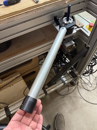

I did pick up the Amana torque wrench for ER32 collets. Having recently lost an expensive bit due to incorrect collet torque, I justified the one time expense. Having now used it a few times with the avid provided tool jig and ISO30 tool holders, I have complete confidence this was a good purchase.
