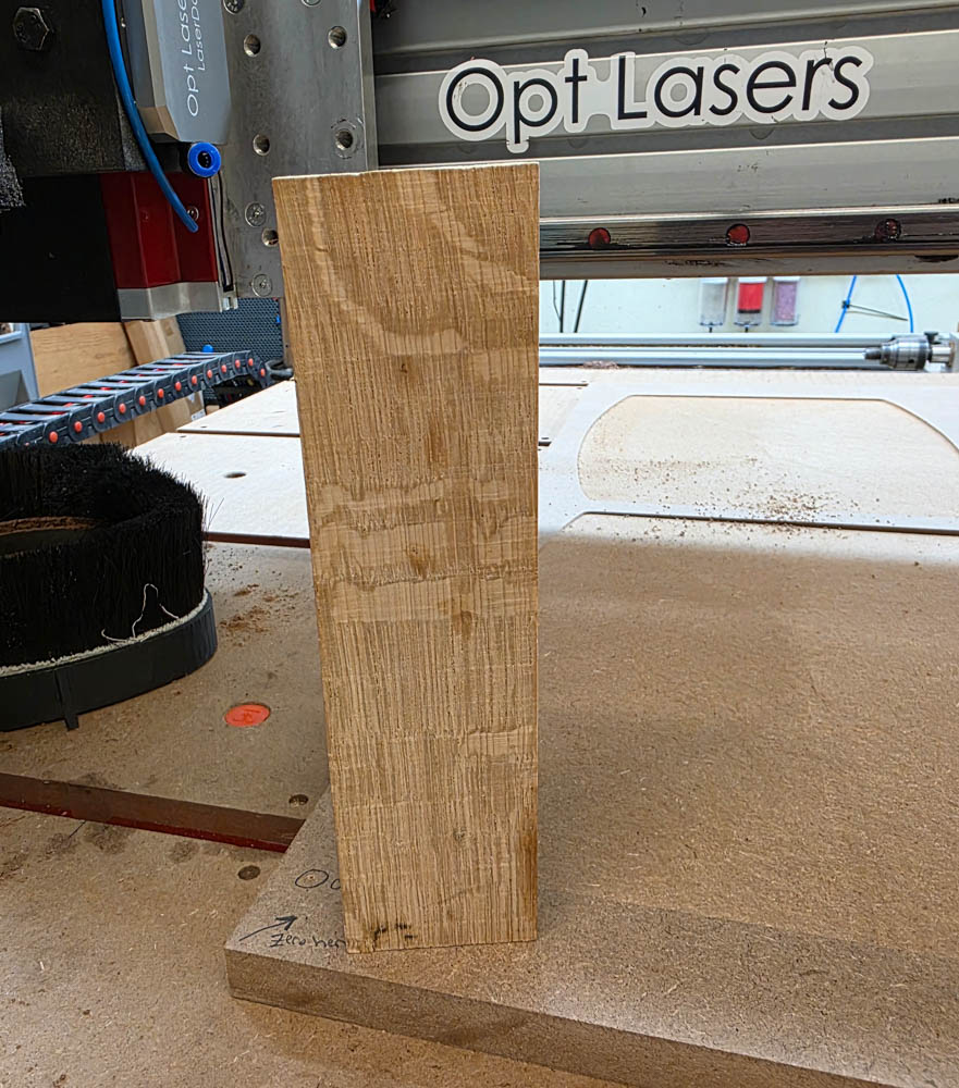

I built my Avid CNC system with Clearpath servos prior to release of the EX-controller. I didn’t put in a Z-axis brake at the time, but my spindle drops about half the time so I use a wood block to hold it up when I park it. :roll_eyes:
