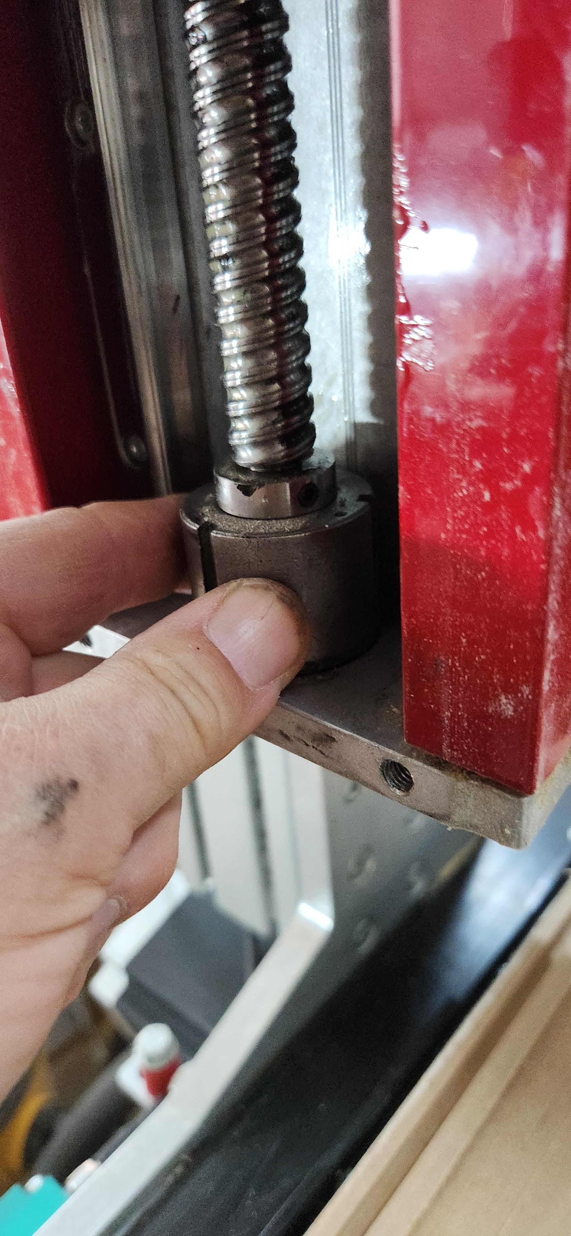

Looking for some feedback on your suggestions. The Picture has a big orange arrow pointed to what I’m guessing you call the Z-Stop? That thing wiggles back and forth about 1/16" of an inch. The video is the machine going up and down with a G0 command.
I’ve checked the wiring. And other than a bend cable right where it comes off the motor into the cable guard it looks solid and tight.

It’s got a clicking…but not what I’d call a grinding.
Thoughts?

That thing with the arrow to it is a brake. Just like in your car. It keeps the Z axis from falling when you turn off the power to that motor.
My understanding is that should not be moving or making that kind of sound.
The factory had me try gluing it down using locktite but that never worked in my case. You could be a squirt and done, dunno! :thinking:
I would write a nice email to support@avidcnc.com and say you suspect you might have a bad brake on your Z axis and that it is causing you to lose steps only in the Z negative direction intermittently. (That is because the weight and orientation btw, it would do it both ways if they were equally loaded)
Share with them your video and photos.
You caught yours early so that is a good thing. It’s easy to remedy. It’s not that expensive either.
At least you have more info! It might be something else entirely though so don’t get sad if I am wrong.
BUT! If I was correct, please mark my reply above as the solution so that others can find it.
Best of luck!

I can move this back and forth with very little effort. Maybe a little spring one direction. And can force the z down with the motor off. Should this be much stiffer?
