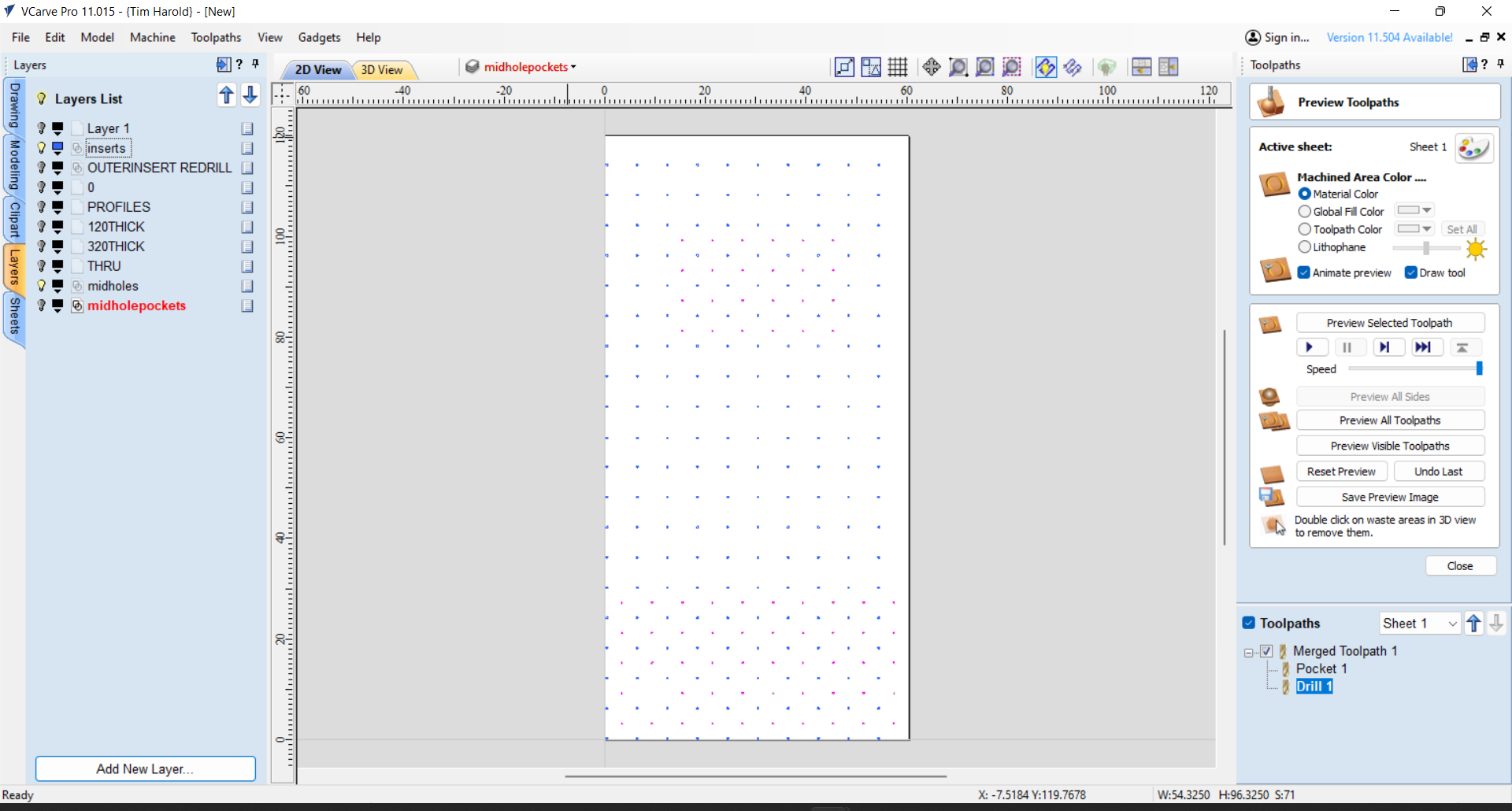

Maybe someone has already said this but when I use screws on a sheet sized project with lots of parts I draw my screw locations on the cad file. Then I run a separate file for those and just mark them about .125" deep. Nest then add them after.
Hi Erik, My process is similar. In the image below is the template I have and use as the starting point for making all toolpaths. Each one of those circles corresponds to a hole in the bed that has a threaded insert embedded. The bread and butter work I do is on 5x5 sheets of baltic birch. For the 5x10 bed, I use a nest boundary that divides the work space into two 5x5 sheets so the nest does not result in parts that cross over the sheets (the nest boundary isn’t shown here). After I nest, depending on how flat the sheets are I just pick holes that are in safe places and machine them out, then screw in a 1/4-20 furniture screw. So Vcarve and my machine always know where I can throw in a hold down. with big parts on big sheets there always ends up being a number of hold down inserts that fall between the parts of the nest. It works great and is worth it once you’ve put in all of those inserts!
But that process is less effective if you are nesting a sheet of very small parts with very little space between. What I’m doing now for that circumstance is nesting first, then moving the parts around manually to make room for hold downs where needed. I would love it if I could just include some hold down holes in the nest boundary though…
