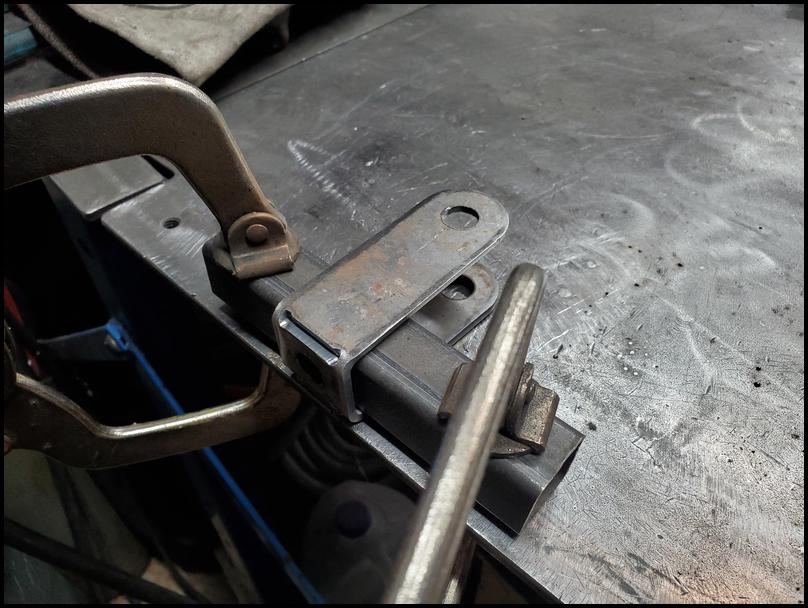

And next up it was back to the plasma table side of the AVIDcnc, this time with a sheet of 10Ga (0.135in) 1018 mild steel. This sheet has some gooe useable places to cut parts from yet left in it.
20231022182402_anim
This next image shows, the part turned out slick and easy. The part has a couple cross cuts where it will be bent and welded up in a follow-on step.
And then the cut piece was folded over a scrap of square steel tubing. It doesn’t show in the photo, but there is a small rectangular scrap of 16Ga(~0.0625in) mild steel under the tube this piece is folded over to leave a little extra room. In a later step those plasma cuts that alow this be be bent up with minimal effort will be welded closed.
