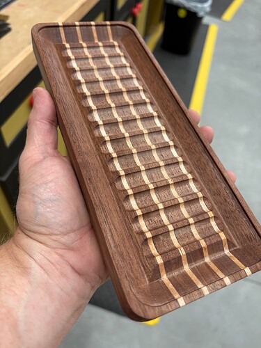

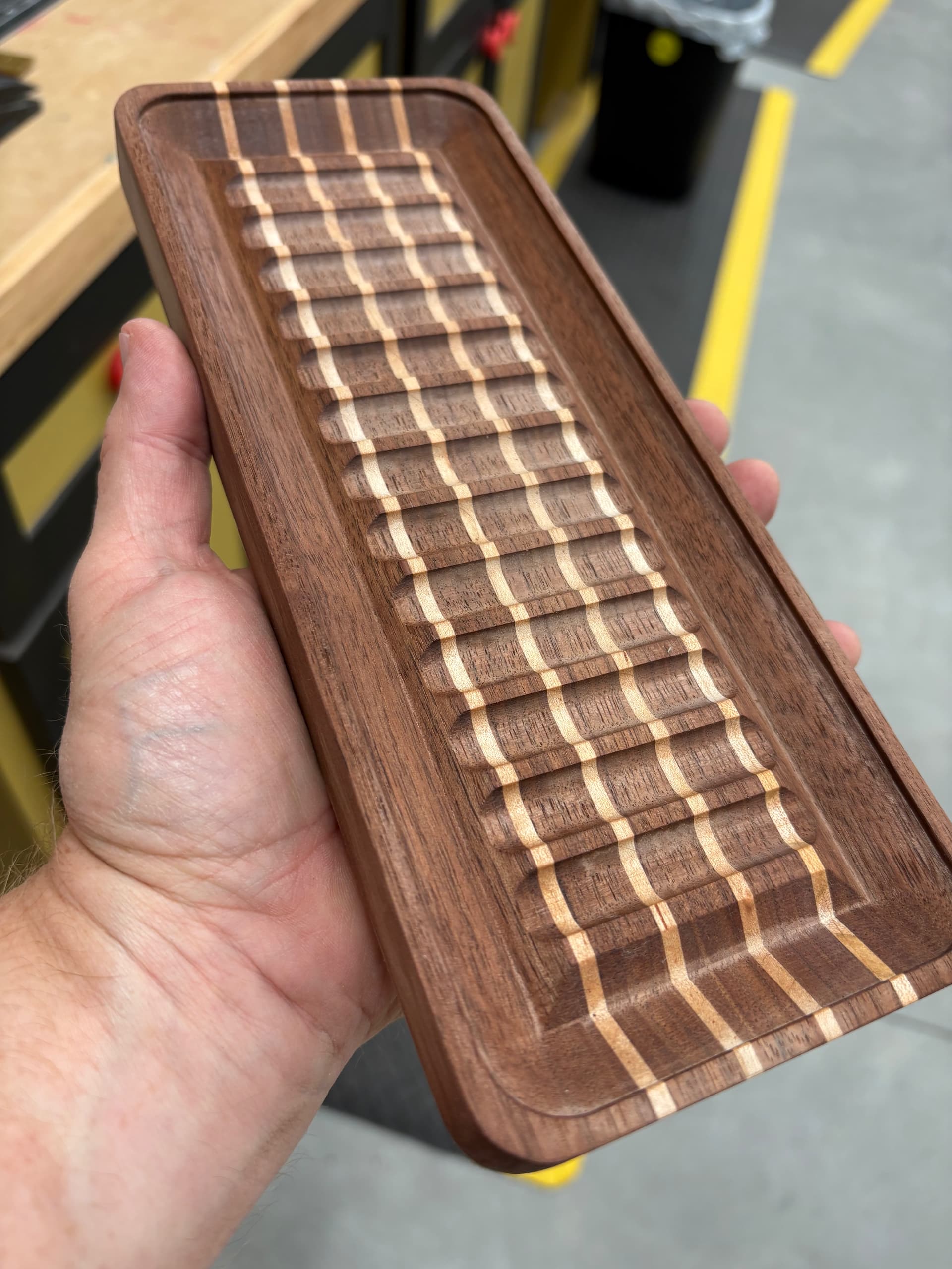

Alas, I present the oversized soapdish! Laminated out of Walnut and Maple, 3/4 x 4 x 10!
Fresh out of the CNC machine:

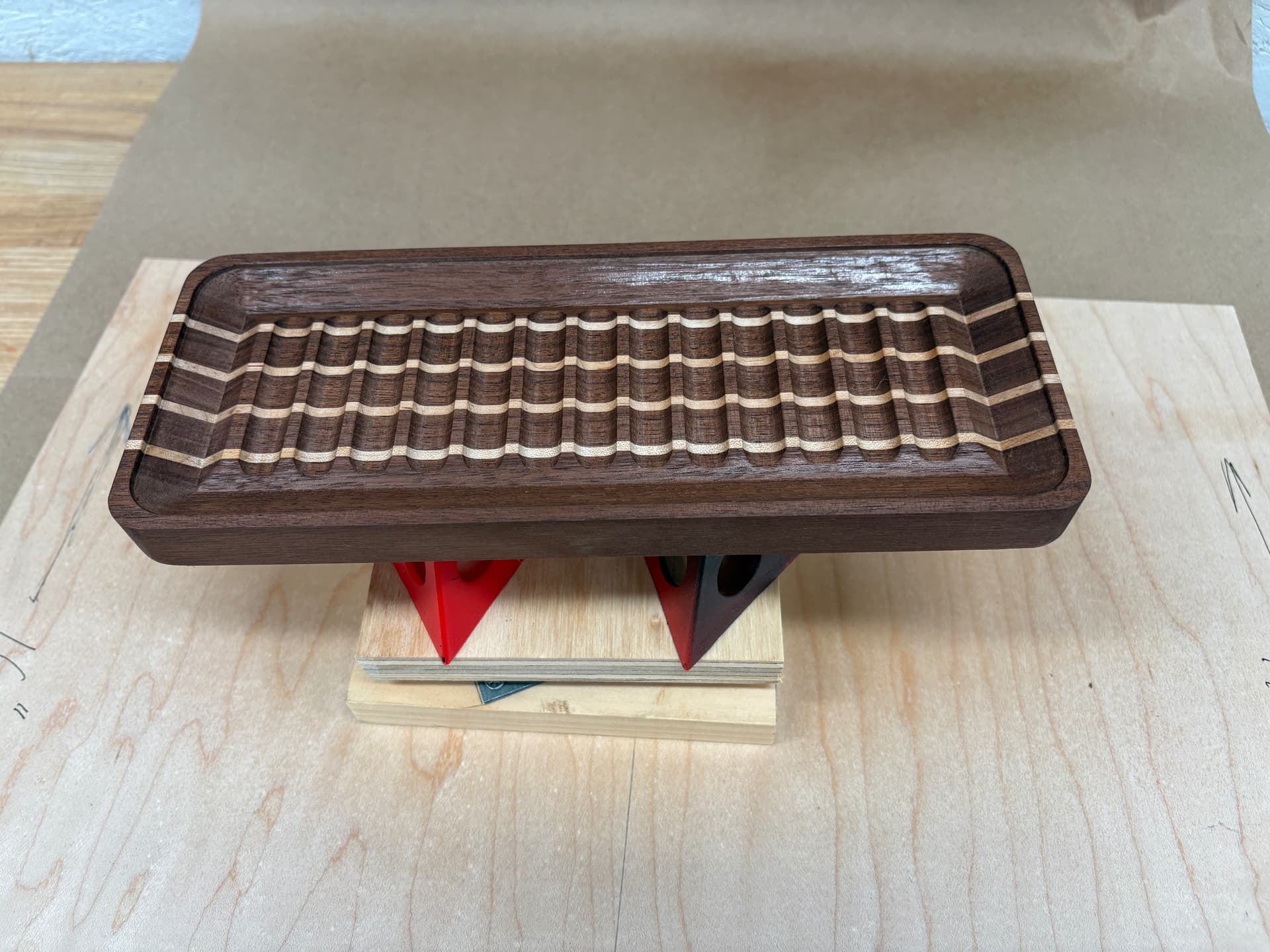

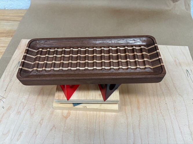

3 coats of Mohawks Pre-Catalyst Lacquer in gloss:
Note: 2 coats were applied to the bottom and lightly scuffed before applying contact cement to adhere a waterproof cork material.

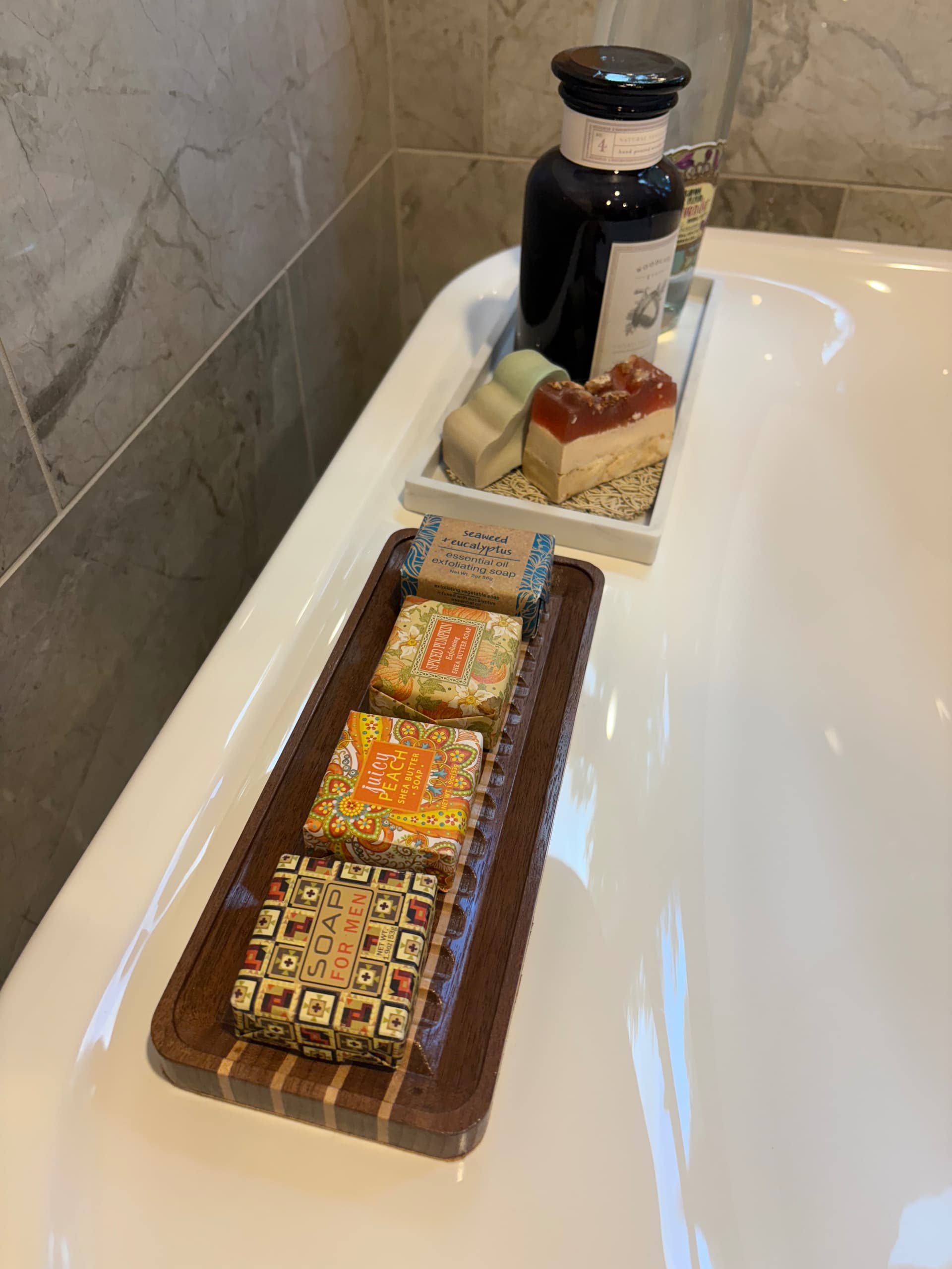

In use:
