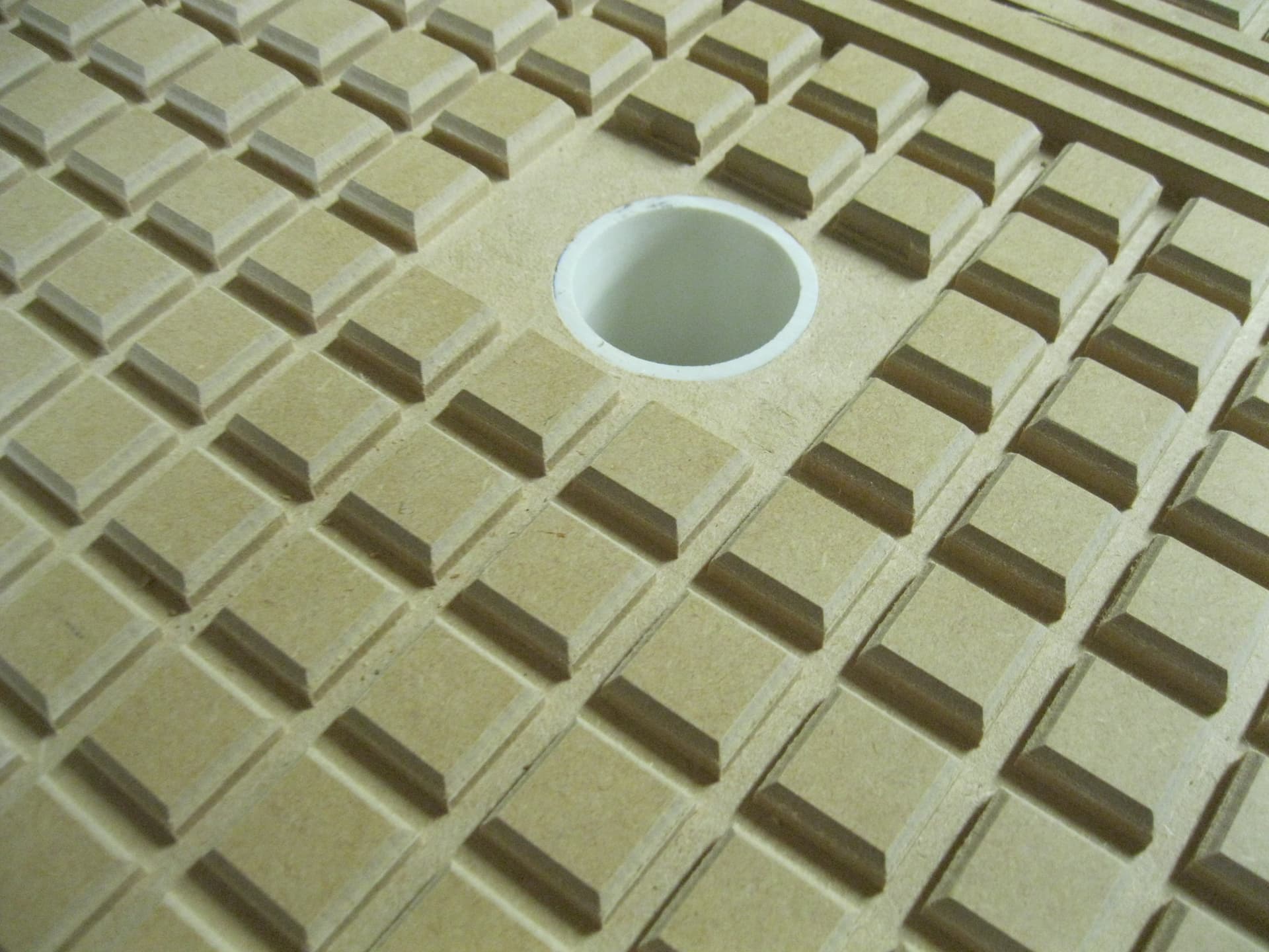

That is what I’m doing in the photos I posted, further above. I’ve got threaded inserts at the bottom of every one of those holes. They are the flange type so the cannot pull through if I over tighten and I put a ring of construction adhesive on each one before screwing them in. It took 1/2-day to get them all done but it has been quite handy… (see photo of the diagonal pattern of holes, further above.)

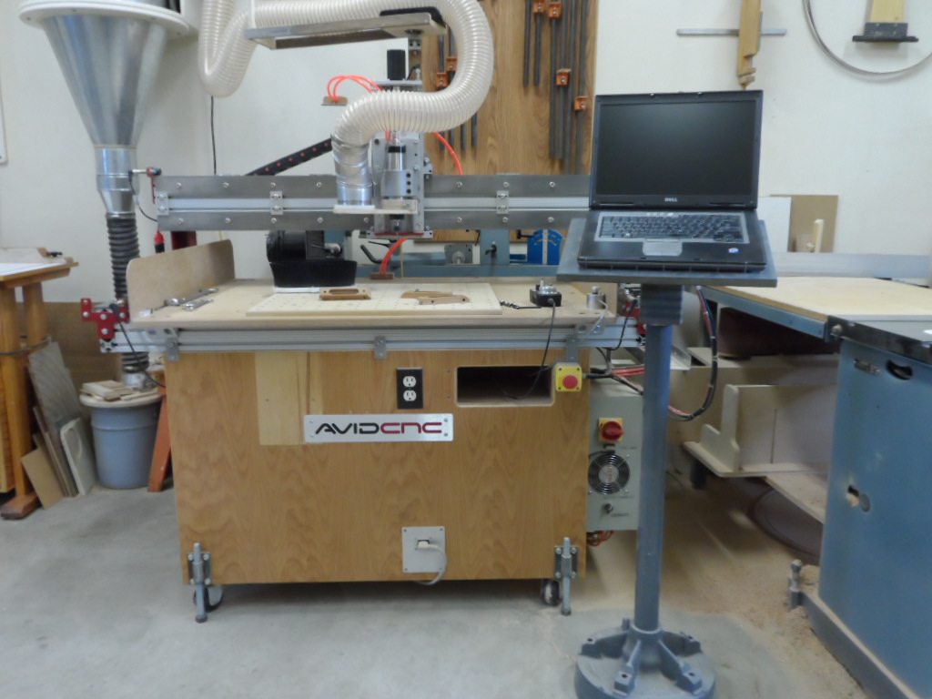

Since Eric asked (re my response to work holding) that I post some pics of my setup. So here goes.
The first pic is an overview of my machine. The galvanized units on the wall make up a cyclone dust collector (shop built from plans in Woodsmith) some years ago. Dust is collected in a 20 liter gray pail. My 24x48 unit is mounted on the base of my previous machine. There is a small amount of overhang on each end of the X-axis, but the Y-axis fit well. The machine is on casters but supplemented by jacking feet barely seen at the bottom of the photo. There are 2 spoil boards: one with threaded inserts on a 6" grid, and a smaller one with threaded inserts on a 2" grid.
The second pic is another view that shows the jacking bolts clearly. Also the stand for the laptop is shown here. The bottom of the laptop stand is a rather heavy wheel providing a solid base for the stand. The tilted base the laptop sits on will rotate. This view also shows the dust shields on either side of the X-axis; this was a great addition. There is a cubby (left of E-stop) for the pendant and Z-axis probe (seen on right side of spoil board).

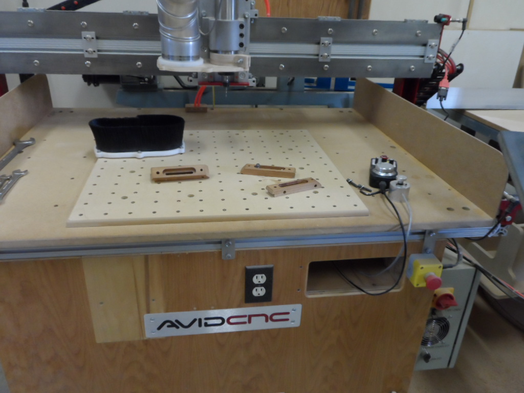

The third pic is a closer look at the spoil boards and clamps.

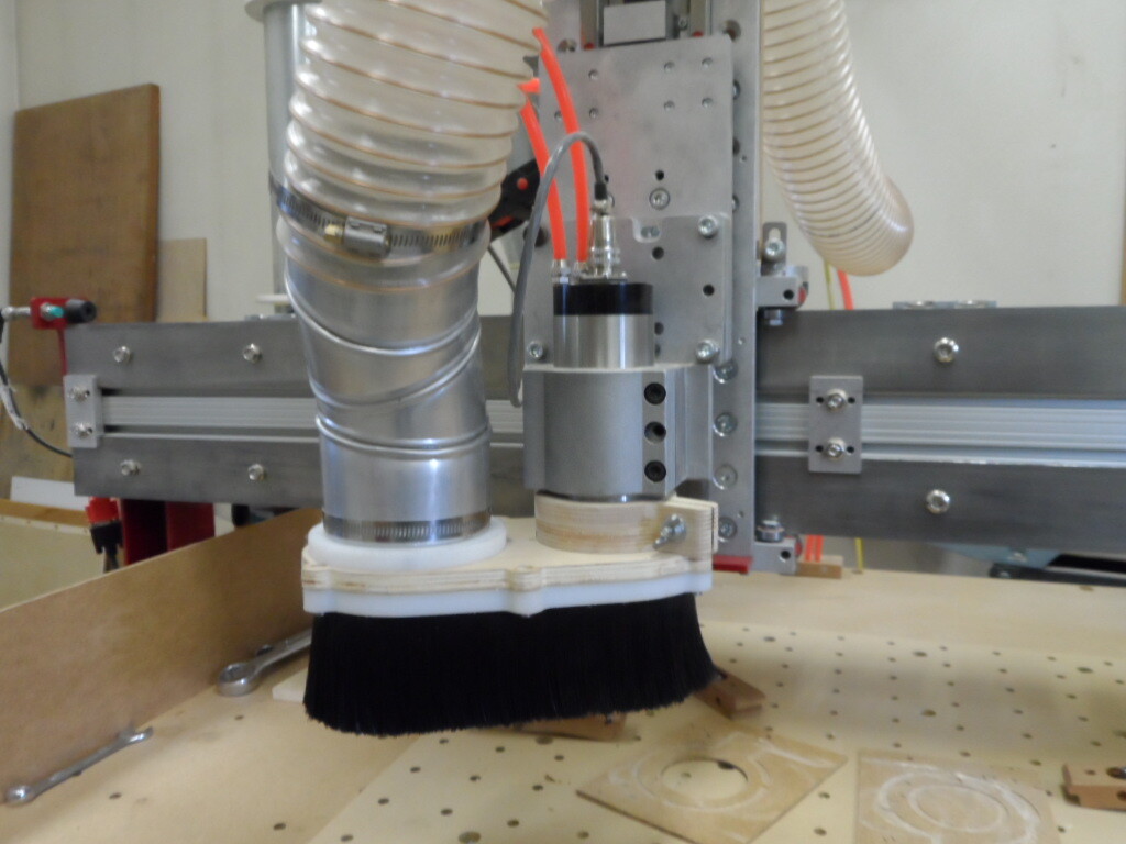

The last pic is a closer look at the dust shoe. This is an AVID design which was made initially for a previous router. The upper portion of the Delrin warped over time such that the magnets wouldn’t hold the 2 halves together. The when I replaced the router with a spindle (Yes, it’s Chinese) the hole for the clamp was too large. So what you see in this pic is a new dust shoe using parts of the original with a wooden upper part and a Baltic birch clamp for the spindle. I’m very happy with the dust shoe now.

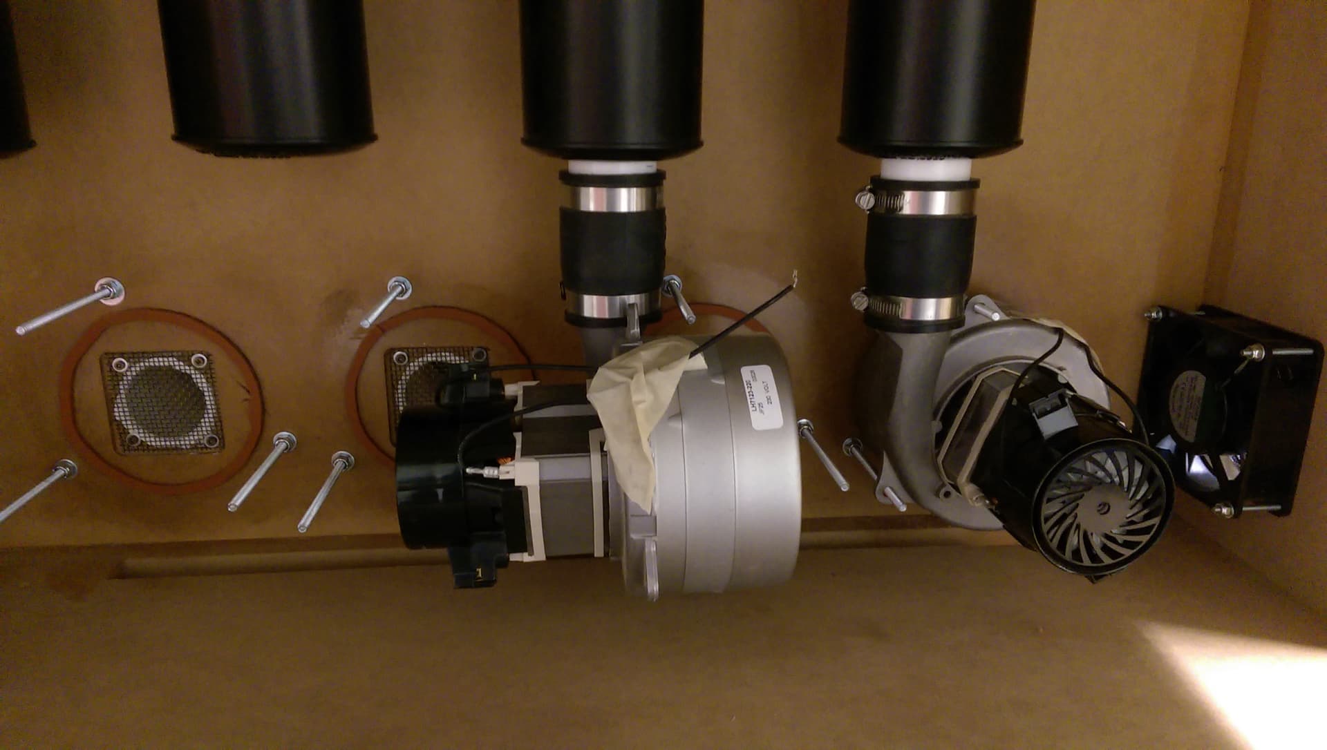

I am trying to decide between building one like you have or buying the black box. If you don’t mind can you share the vac blowers you used?
Thanks
I am sorry, there is a sticker on the motors, but it is in a almost impossible place.
It’s been a long time since I built the system (still works perfectly)
Jut found a better pic from the build
Hope this helps
Ray
Yes this helps, what is the black pipe off the discharge side of the blower a muffler? If so can you share any details?
These are mufflers for built -in vacuum systems. I realized afterwards that the first pic I sent in the last post, I took for you that night. The second pic I found in my files, and are from the guy I got the idea from. That is why in the first pic the mufflers are white (mine) and the second pic was his (black|)
I will send you a PM, and if you want we can exchange e-mails, and I will send you a lot more info I have including wiring diagram
