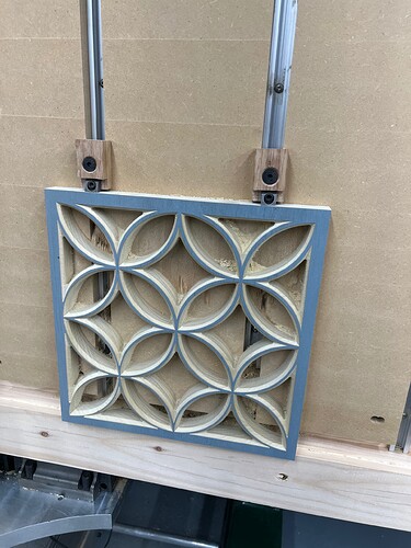

I built this one for mine. I wanted a smaller one that didn’t take up the whole front of the machine and wanted to be able to set angles. Simple, but works well.
That’s similar to this one I made. What are those clamps you have in yours @Fcfnc ?
I’m using the matchfit dovetail clamps.
https://tinyurl.com/mrybd72a
A dove tail track… that’s a great idea. Cheap and it’s not something that you would potentially hit with a router bit.
