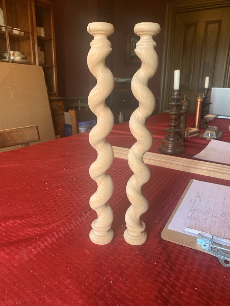

I’m making these barleytwist columns and it requires a tool change for a smaller tapered ball nose bit at the end, but after the tool change and after the tool has touched off it throws a z axis fault saying it’s beyond the z axis limits, so I can’t complete the file. I’ve looked at the gcode and can’t find anything different than the first tool change, which works correctly. I’ve run several other files with tool changes that work well too. The only thing I can think of that is different is that this TBN bit is a bit longer, but it doesn’t make sense to me why that would trigger the fault. Avid Pro with EX controller and tool setter. Any Ideas?
