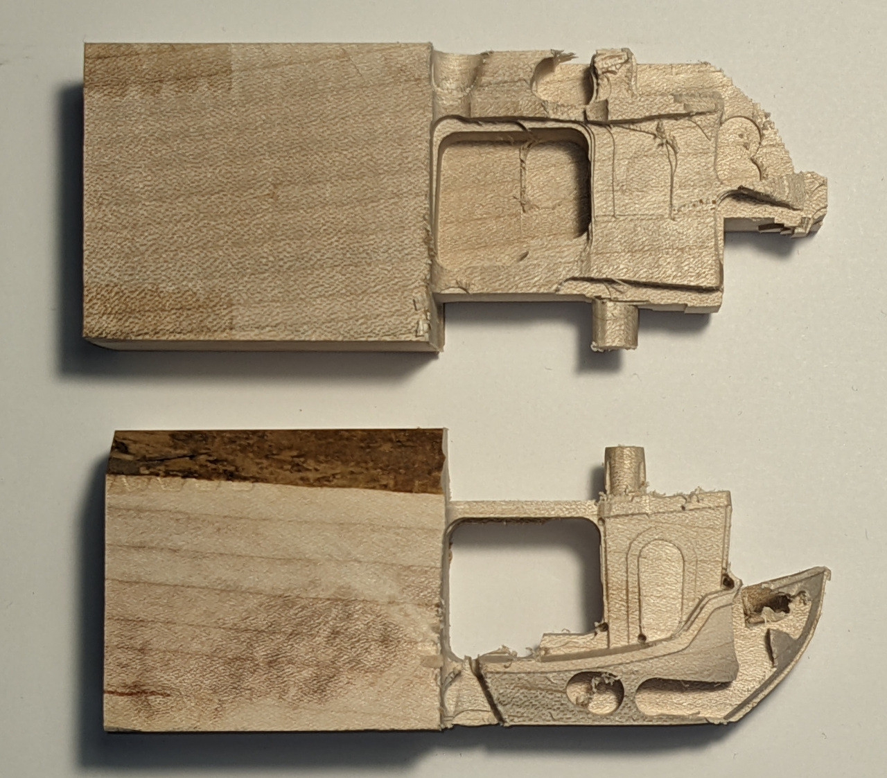

This weekend’s project was to get better at using the rotary axis for carvings, as I’ve had customers ask when that feature would be available to them. All I needed was a benchmark…
My operation plan was to use a 1/4” straight bit to rough out from each of 0, 180, 90, and then 270 degrees. Then use a 1/32” ball carving bit at every multiple of 45 degrees.
The top picture was my first attempt. The roughing at 0 and 180 went fine, but the 90 degree op made it obvious that I had wired the rotary motor backwards! Can you pick out the two smokestacks?
The second one went better, but that’s when I learned that there’s two ways of specifying angles, and the software and machine disagreed. So when the software asked to go from 90 to -90, the machine went from “90 degrees” to “90 degrees, counterclockwise”. I.e. it expected positive angles with the sign for direction :stuck_out_tongue: Net result, it didn’t move, and started roughing over the finished side. I fixed that and tried again, and it did some of the finishing pass before the collet nut hit the uncut wood on the left (it’s on the back side) and I had to stop it.
I also realized I had to recalibrate the rotary axis, so I did that. I might have time to do more tests today, but I thought I’d share my “results”, either as a lesson to others, or at least for a laugh.
So my challenge to you all who own rotaries: Figure out how to carve a benchy! I think doing so covers a lot of learning opportunities. Post your failures! (and your successes :wink:
