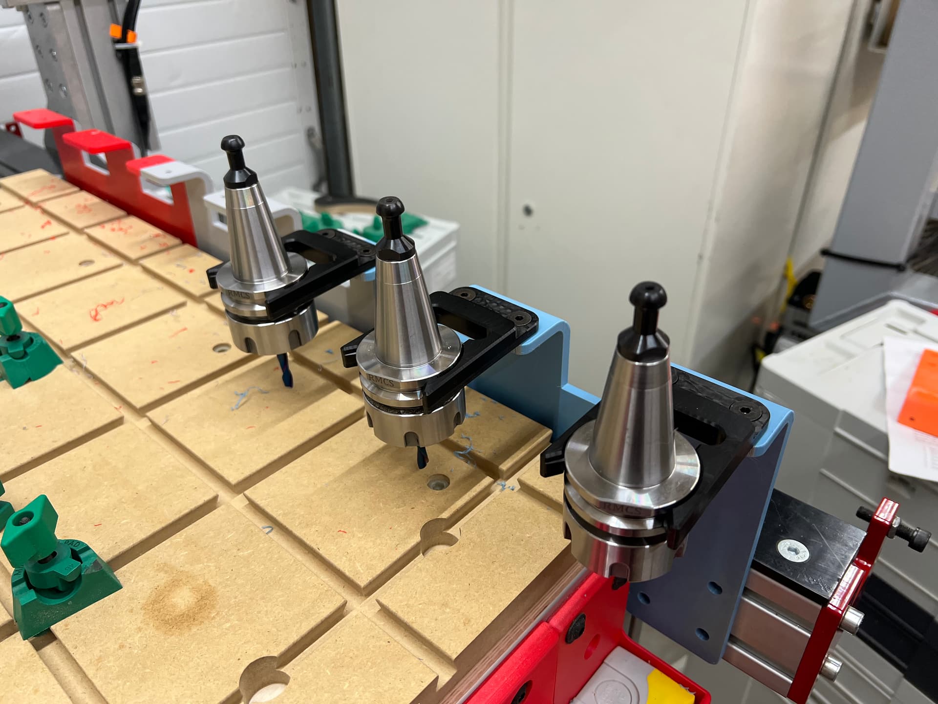

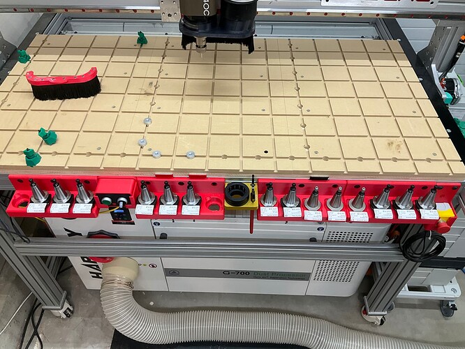

You could stick some amazon tool forks onto a 2x4 screwed onto the back of your table. I’ve come to realize that it doesn’t have to be too precise to work well.
@corbin - I modeled a rack using Portland cnc forks and send cut send will make it for me for ~ $175. Only downside is I’ll have to steal 6” from my right side. But it’s a 5’ gantry so would take me to 4-1/2’ wide.
Oh yeah, I saw your pictures of this earlier, and it looks great! I am looking forward to Avid’s pneumatic rack; I lose a lot of space at the end of my 8’ table for my rack. I occasionally unscrew it to cut longer pieces, and drop it back on and don’t have to re-align anything (the screw holes are good enough, and it doesn’t have to be too precise). I could do pneumatic myself…but it never was a priority.
I’m super keen on the pneumatic rack as well, which is why I’ve been holding off… but now using your profile changes is making me want to throw in an interim solution.
