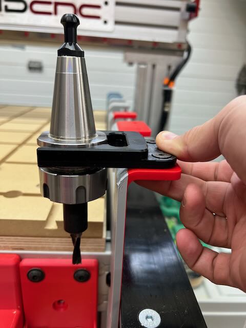

I have been using Corbins’s stuff for quite a while and even went from using forks to 3d printed cups so there is no slide necessary. It is working very well and I gained back my full bed length
I hadn’t considered cups. I have a mixture of ER20 and ER32 tool holders so I’d have to be judicious about making cups work.
I think Chad got his up cup design from Pwn CNC: Tool Rack – PwnCNC

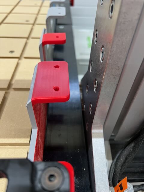

I started on a design but never finished it. It’d be cool to have an indexable square bottom that attaches with strong magnets and/or some quick release bolts. Then you could easily remove them to get extra cutting area.
Now that I think bout it… a sliding fork design would probably work with that idea too! Some people are using my 3d printed holders with good success. I didn’t use them as I thought they were too weak.
I just looked at the tool cups, and then it occurred to me that a lot of the room I’m stealing from my work surface is due to the minimum bend radius for send cut send. So… for grins and since my tool fork rack is a mirrored design, I reversed it and attached the forks to it and reclaimed 2”+ of work surface!
I don’t think I’ve ever used materials over 54” in width so 4” of loss is not going to be a problem at all. Thanks for making the brain juices flow!

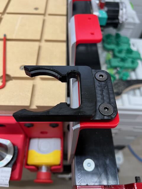

Nice! What material did you use for the holders? Did you design the forks or find that STL somewhere? Any strength issues?
Look at all those tool forks! I only get 7 tools :joy:
I used pteg used your base design but modified and used a fork design off of thingyverse but modified. Seems pretty strong have pushed it a few times jogging to fast and no breaks. I can share if anyone is interested.
Yeah, send me the fork design (CAD/STL/whatever) - I’d be interested to check it out! corbin at corbinstreehouse.com
Here you go, let me know what you think. I have not had a chance to run them in a successful tool change. Hoping to hear back from avid on how to get the drawbar to unclamp on the av70s. Thanks for all your downloads, used your dustboot, the atc download (have all locations set) and your base started this design.
