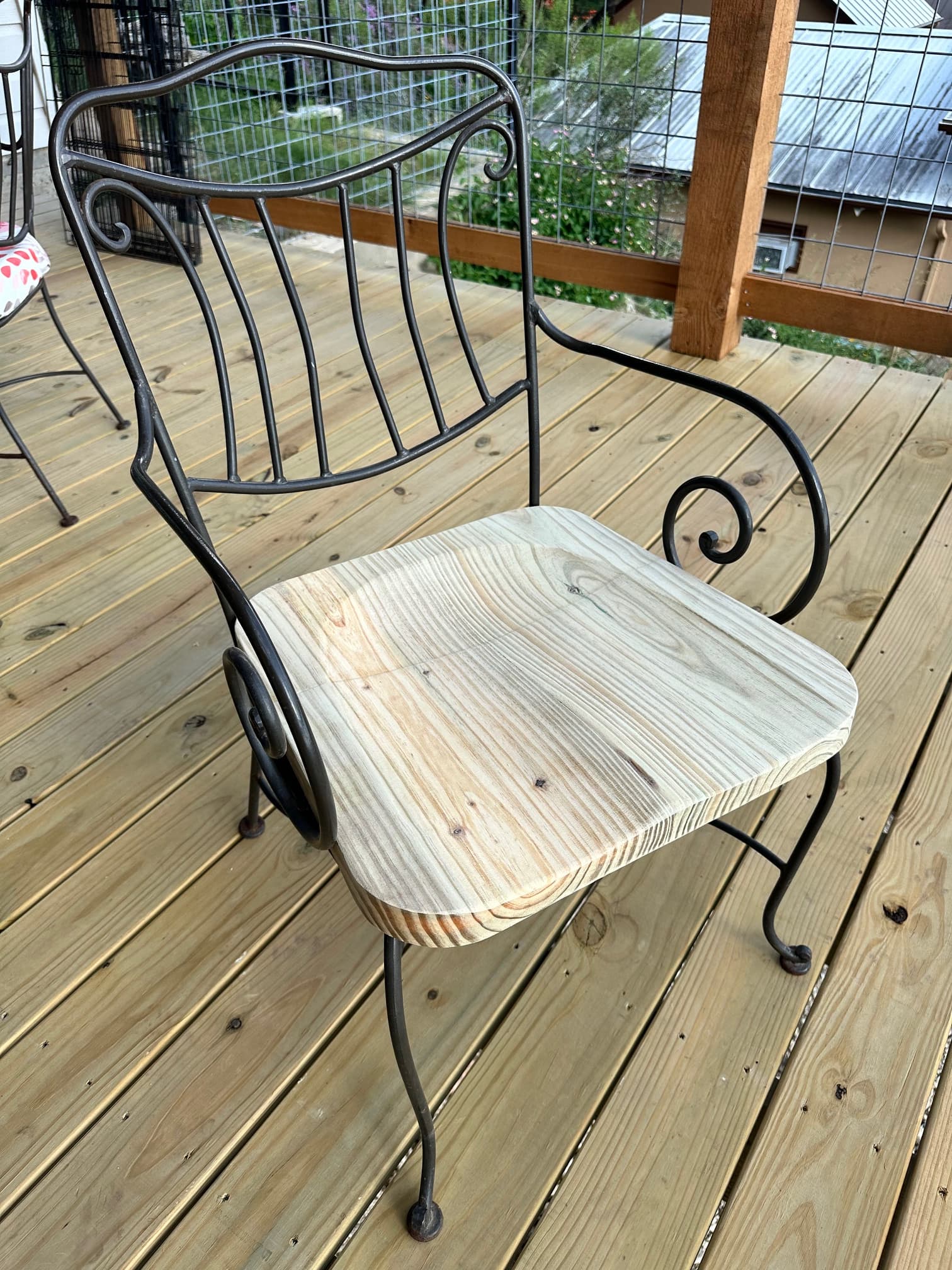

Prototype Maloof chair seat for our patio furniture. Some lessons learned about the new system and the design. Design needs some tweaks to work for the chair but overall very happy. I was running thecarve finishing tool path at 600ipm feed and plunge. The tool touch of signal kept triggering and I would get a warning on the screen then it would clear. This happened over and over. It didnt effect the project but its definetly courious. Anyway here is a picture.
