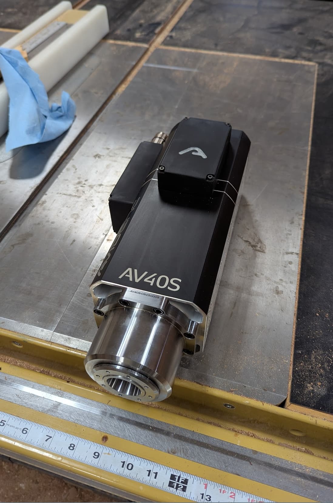

Just received my new AV40S spindle
Just got back from vacation and this was sitting on the porch waiting for me. Gonna take some time to rewire everything and get it going since my system is not exactly plug and play :laughing:.
Really nice fit and finish on this thing. Only concern is the covers over the electrical components are plastic. Hopefully its a lot better plastic than what the connectors were mounted in on the Hiteco (those were pretty fragile).
Its seems really heavy, but I must have forgotten how heavy the Hiteco is in hand because the spec says its only a Kg more than than the Hiteco.

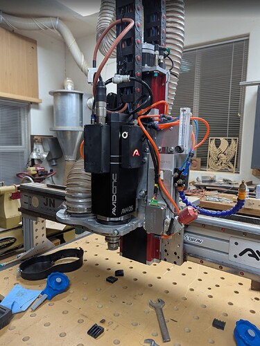

Install went very well. Took me about 2 hours, including grilling the bratz for dinner.
This thing is really quiet. The fan is powered by a 24V motor, so its constant speed relative to spindle rpm which makes it super quiet compared to the spindle powered fans at high rpm. The other nice thing is that since cooling is independent of rpm, you can run this one down to 1000 rpm (thats the spec).
The 4 tool holders are very good quality and come with nuts, and there is an assortment of collets as well.
The other thing thats really cool is it comes with a drill chuck tool holder. It also is very good qualitty (I measured about 0.0005" runout on one of my quarter inch endmils).
It comes with a power supply and air line and regulator to get it set up in manual mode with minimal effort. This is where I’m at right now since I need to add a Centroid ether1616 board to get more I/O before I can fully automate this for ATC capability.
