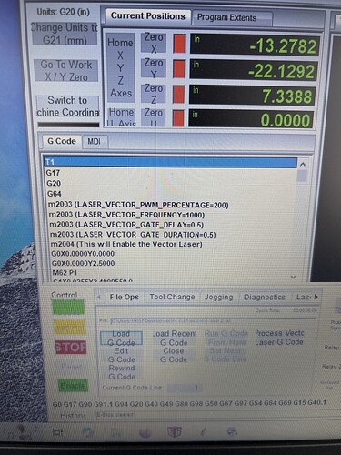

So I have not been out to the shop for awhile, And went out today to run the laser and the test fire still works but when running a gcode with 62 PP it goes to the first gcode line and stops?
What does it say down in the History window after it stops?
thats odd. When you say the test fire works, you mean from the Mach4 screen, not from the Opt adapter box, right?

This is what it says when I run gcode. Someone smarter than me entered the m67 e1q1 to make it fire. Which worked but only when manual
Looks like there is.
Your will have to forgive me though, I don’t know what macros are yet, and what I’ve sent picture of is gibberish to me .
Ok, your macros are there, but I can see that a lot of your laser settings are wrong from that first screen you posted.
Lets back up a little. Do you have the standard laser kit from AVID, or did you install the Opt laser by itself?
That screen/code was altered to make it fire, so I’m not sure that’s what it would look like in normal circumstances. ( again, I’m not sure what changes were even made) this is what normal looks like
I have the universal laser kit from opt. Set up from the videos that avid/opt/youtube recommended. I don’t have the deployable laser system so I only have the 2 wires connected. One to a ground maybe (18) and I may be remember ing wrong , but the pwm on 7 and a fake gate set up on 8 or something like that. With the corresponding changes made in the plugins/configuration.
