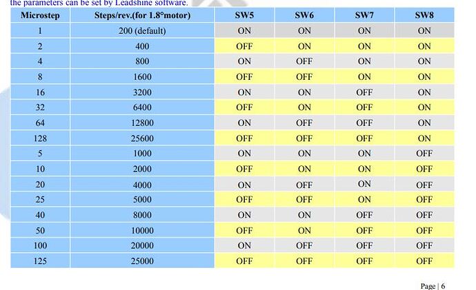

I set the stepper driver for the R&p to 2000, see drver specs.
On a test cut, my Z depth was fine, but my X and Y ratio was at least 50% or more smaller than what it should be. Does anyone know what I need to change in the motor tuning steps or stepper driver settings to get my sizing ratio correct? Thanks .

Make sure you have set the DIP switches correctly. If you accidentally picked 5x microstepping instead of 10x it would account for the half size movements.
