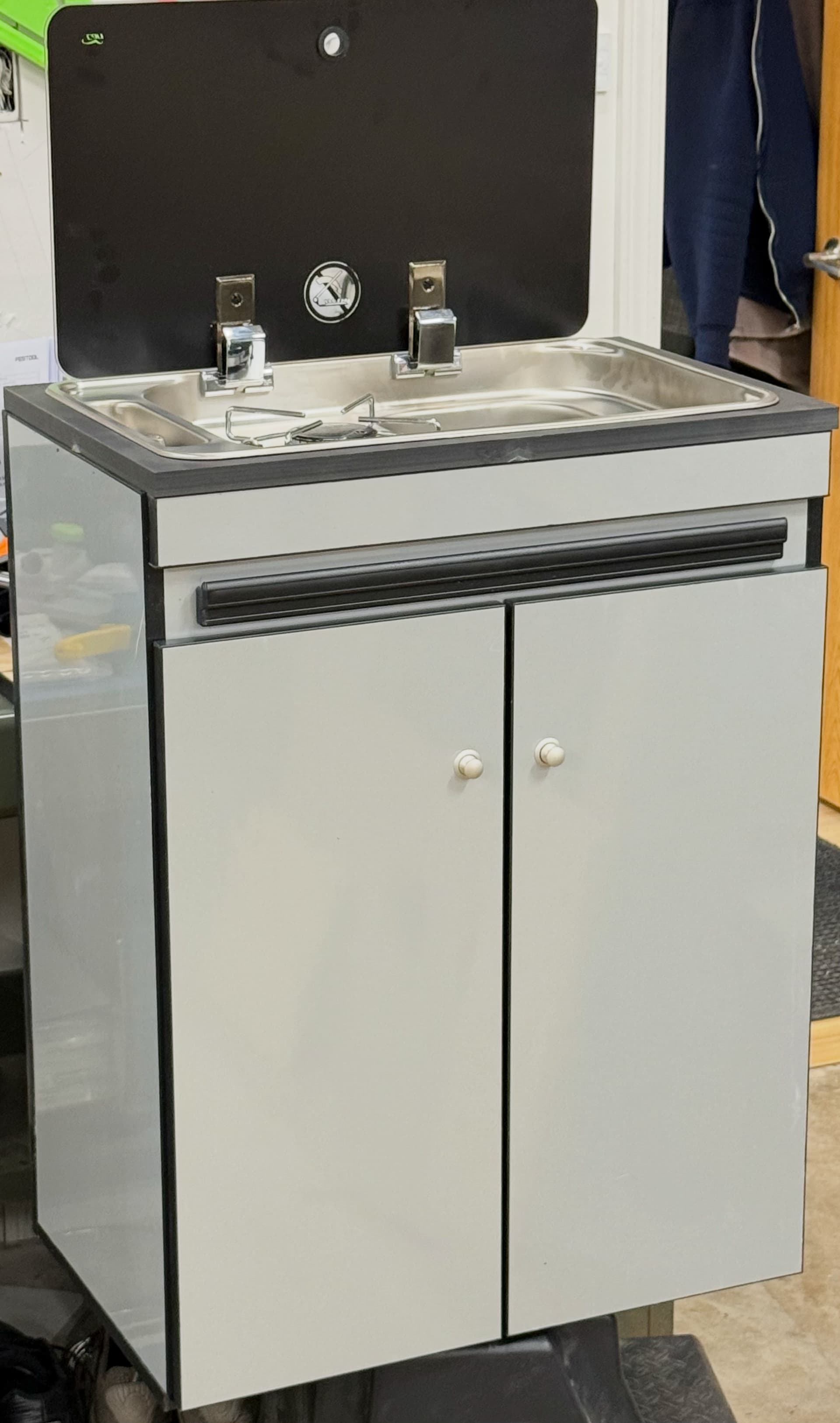

Yes! intense smell of something burning, but couldn’t find it. Almost called my shop neighbors, and then I realized it was me. Here a couple pics of the van cabinetry. European style, different from the US industry standard cabinetry.
That looks great! As a former kitchen designer us 'Muricans need to learn to adopt european cabinet design!
