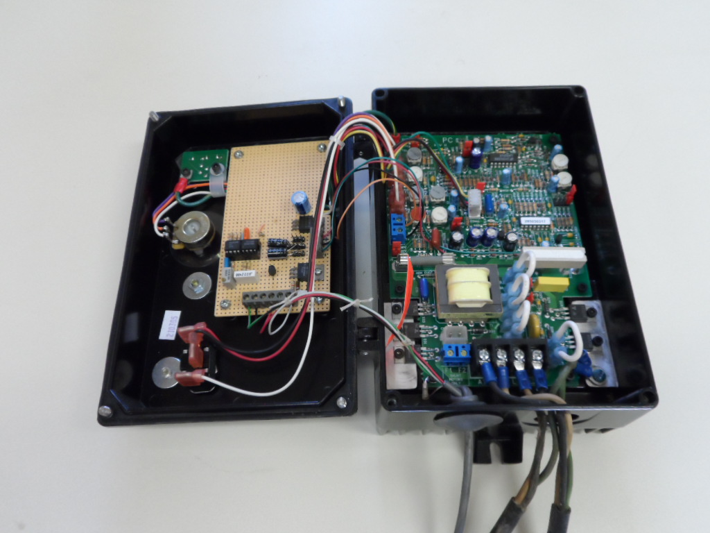

The photo below shows my Phoenix horizontal mill; it differs considerably from the original design. The head assembly was cast by one of my buddies. We shared machining tasks on the head. The section with the link belts is my design. The original used multiple stages of step pulleys and jack shafts taking up too much bench space. There are no step pulleys here. The DC motor seen at the top was salvaged from a centrifuge and is speed controlled by a standard KBC DC Motor Speed Controller.
Below is the speed controller open showing the tachometer circuit added.
