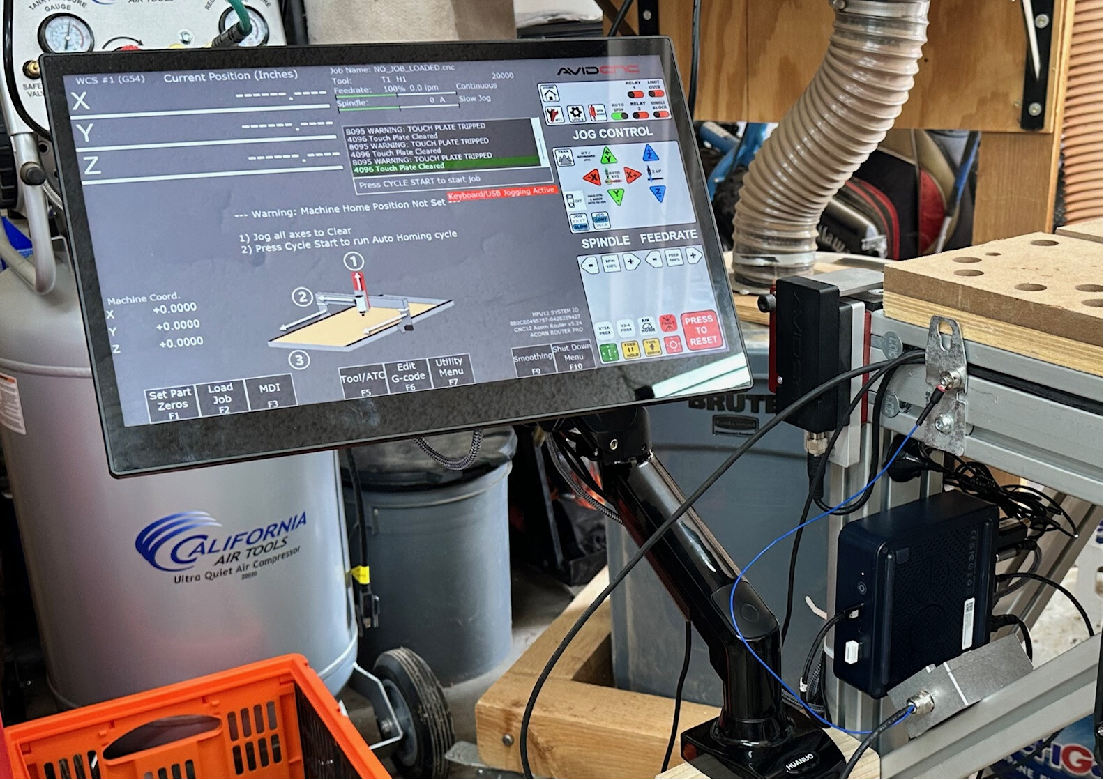

I bought a mini computer for a couple hundred bucks and dedicated it to the CNC. I added a 200 dollar touchscreen and I dont use that PC for anything other than running Acorn. I use a laptop for all my design work.
