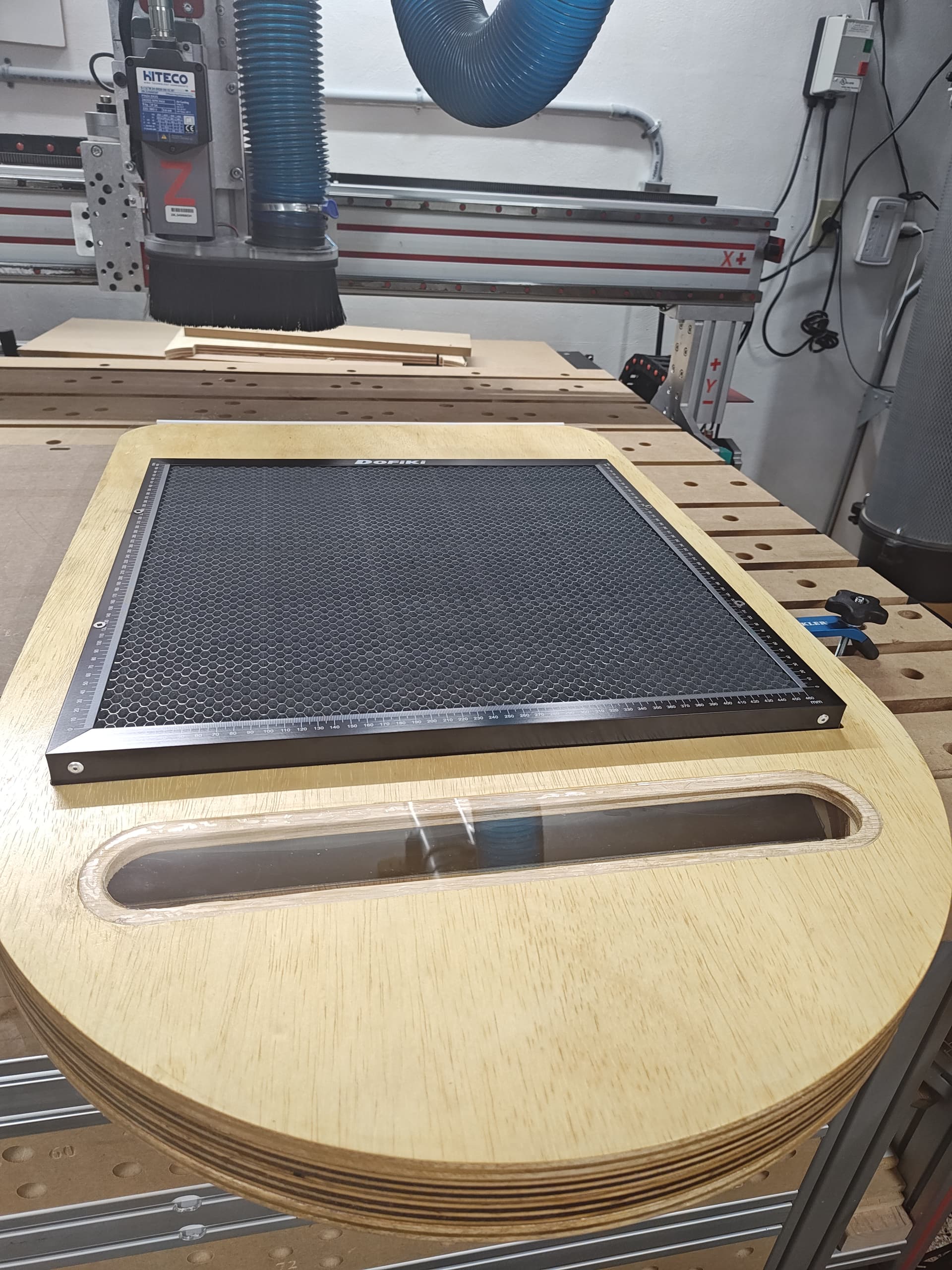

That looks like a smoke extractor?
Yup, I have that hooked up to an exhaust fan. It worked better on the 15 watt laser, this 45 watt has a really strong down draft fan which really fights against this…
These downdraft tables work better:
Yes I listen to what you guys were saying and I made my own version haven’t had a chance to use it yet but it seems to work pretty good :blush:
I think that’s the best answer honestly. If you cut smaller parts on it you can cover sections of the table with scrap cardboard to direct a little more suction where you need it
